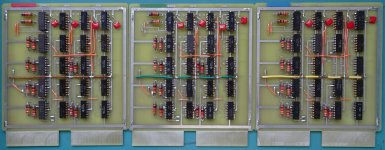

At the front of the backplanes the entire main memory unit is now installed complete with the guide rails for the PCBs. At present I can only operate the main memory for short test periods until I have installed the cooling fans with their housings. Above the main memory are the first few PCBs for the control memory. One of my pending tasks is assembling the rest of these. Although I am currently only installing circuits on the first backplane I have already installed the second backplane above it so that I can use it for temporary test circuits. An advantage of wire-wrapped backplanes with plug in PCBs is that temporary circuits can be built quickly and then stripped out when no longer needed.
This closer picture of the PCBs shows how essential the guide rails are to keep the boards at the right spacing and allow air from the fans to pass between them from one end to the other. In reality during normal operation the backplanes in a complete machine are mounted inside the cabinet with the PCBs vertical and the fans at the bottom but they are rotated out of the cabinet into the position as above during maintenance, so I will locate the fans on the right hand side. In my design the PCBs that generate the most heat are all on the left side, so at the top when eventually put inside a cabinet . . . some time in the distant future maybe!
