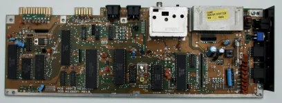

    Desperado replied to the thread C64G RAM ISSUES.
    I replaced the ram sockets to be safe but it still gives the same problem...at every start, I have a different amount of ram on the...
    there were a 4464-12 and a 41464-10...I replaced them with 41464-10
    Must i check /CAS, /RAS and /WE signal for each dram?

    Desperado reacted to daver2's post in the thread C64G RAM ISSUES with Like Like.
    Well, the 64GS was the best manual I could find containing 41464 DRAMs as an example of how they would probably be used for the 64G. It...
    Dave the manual you attached is for the 64GS console...
    I read that the 64G has the Super PLA that manages the RAM... is it possible that it got damaged?

    Desperado posted the thread C64G RAM ISSUES in C64 and C128.
    Good morning everyone, I have a Commodore 64G that seems to have RAM issues. This board uses two 41464 RAM chips, and it often starts up...
