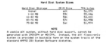

P.S. - You mentioned using SYSTEM1.IMD. According to the A74015A AMPRO Z80 Hard Disk Software Users Manual 1985.pdf you may need to SYSGEN a system disk with a smaller TPA in order to have a bootable floppy image that supports a hard disk.
Way ahead of you. I ared tee eff em and got things working pretty nicely, actually. I used MOVCPM (rather than ZMOVCPM) to create a 56K CP/M image per the suggestion for an 80MB HDD, then created my hard disk. I even installed NZCOM on one setup, and QP/M (which required me to do a bit of wrangling with SYSGEN to make work) on another (albeit on floppy).
