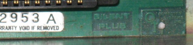

I managed to get a closer look at the card cage/motherboard, which is from "QT Computer Systems", this one is dated 5/12/82 so it's obviously a fairly late addition.
