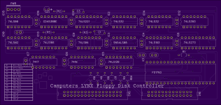

The disk interface is interesting. It used an interface that just contained a ROM with the disk operating system and an actual interface with a FD1793 on board. Never seen a set for sale but someone has produced Gerbers and the IC's used aren't rare so have ordered the parts :)
Interestingly, the PCB disk drive interface calls for a SN54LS08 rather than a 7408. I know the basic differences but I wouldn't have thought a military grade logic chip would be needed over a standard 74 ? Maybe a 74LS08 might be too slow, but I can't see the extra current draw of a 7408 being significantly problematic ?

Disk interface next
PCB's from here https://oshpark.com/profiles/gruffdba and ROM image from here https://github.com/ukscone/Camputers-Lynx/blob/master/Software/eproms/lynxdosrom.zip
The first board acts as a ROM expansion board carrying a 2764 EPROM with the Lynx disk operating system on board. Built this first and tried the command XROM only to get a Syntax error, how odd.
Looking though at the schematics (https://ibb.co/1RgjbNK & https://ibb.co/6RYxKkd) the chip enable pins are pulled low by the next board which carries the disk interface itself, which is sort of clever in that the DOS won't start up unless the disk interface is plugged in.
So completed the second board but with a couple of substitutions awaiting the specified parts. First is that the circuit wants a 54LS08 rather than a 74LS08. Can't see the reason for this as the specs are so close for the voltages I am using as to not be particularly necessary, but I will keep it in mind if it doesn't work. The second it specs two 120pf capacitors for the timing of the one shot IC CD4538 which is probably more significant.
I have a pile of ceramic 100pf's so just trying them for now.
All plugged in and the Lynx now responds with
Lynx DOS Vers. 1.0 HIMIM=&F51E
Which looks better. Just need to wire up a Gotek now but the PSU hasn't got another floppy supply connector. I have bought new plugs and pins so tomorrow it will be a job of making up a new connector.

First board installed on the museum machine and working fine.
Built a second unit using an SMC FDC1793 (Rather than the Western Digital FD1793) and it doesn't work. Put the WD chip in and it works fine.
It might be a failed chip but in all other respects it works, heads step, format pulses being written, it just doesn't read.
Built a second unit using an SMC FDC1793 (Rather than the Western Digital FDC1793) and it doesn't work. Put the WD chip in and it works fine.
New WD FD1793PL-02 inserted and it works fine.
