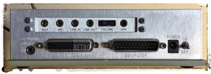

Dunno if this is the right place in the forums.
I'm getting a 386 system without a cd drive, no sound card and no expansion slots.
I really want a CD drive and audio for some games. Can I solve both of these problems with an external CD drive with a parallel port connection?
Want to play the CD version of Monkey Island and similar with sound, would that work?
The backpack CD-Drives that support sound, from what I understand, only supported sound in Windows since the driver is a windows sound driver. So yes, but you will not be able to use it for games needing soundblaster compatibility. It will give you sound in windows and windows games.
CD audio for music in games will work if you connect the RCA jacks to speakers (or the headphone jack, if that's all you get). Sound as in "sound card" won't, as there is no hardware in a CD-ROM drive for that.

Just remember that OPLxLPT devices won't work with protected mode games without the game being patched to look for the Adlib on port 378h instead of 388h. Also, said devices won't generally work for PCM SFX. While the OPL2/3 does have a single ADPCM channel, most games don't use it because it requires the host CPU to do all of the heavy lifting to play the sound sample. This is why arcade/console boards with FM chips generally had a dedicated CPU (usually a Z80) to run the sound driver on so the main CPU could be free to run game code.
