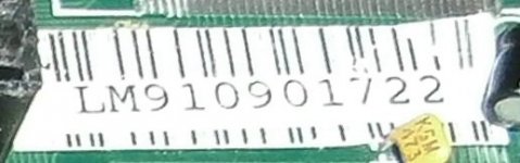

I have a 286 board, but it has some missing parts (3 resistors and 2 transistors). I would appreciate if somebody has the same board and tell me exactly the values/ID for these parts.

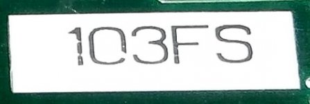

The board itself has no brand, but it has 2 stickers: "103FS" and "LM910901722". The 1st one is probably the board model, but the 2nd one could be just the serial number. This board is found in TH99 under the name "Unidentified LM-103".
It is a late 286 board manufactured in 1991 week 20.
On the back side there is a square logo with "HS" or "HCS" letters folowed by "-A-200".
It has a 16MHz 286 and the chipset is a "Headland HT12/A". It came with a 287XL

ID stickers:

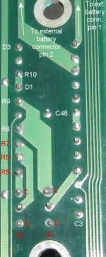

I tried to track where the parts connect to. I did it with an older 286 board (to figure out what jumpers were for) looking at the tracks in the front and back side of the board. Unfortunately, this late board seems to have internal layers, as several pins aren't soldered to any track neither on the front, nor in the back side. But, just in case, I upload a photo of the back side.

I used the multimeter and found new connections:
Q1E is connected to PS connector +5V
Q1B is connected to R5 left side
Q1C is connected to external battery connector pin 3
Q2E is connected to R7 left side
Q2B is connected to R6 right side
Q2C is connected to R5 right side
R7 right side is connected to R6 right side
R8 right side is connected to external battery connector pin 3
R9 right side is connected to external battery connector pin 3
CMOS chip (HM6818A) pins 16 (-STBY) and 20 (CKFS) are also connected to external battery pin 3
Barrel battery + is connected to external battery connector pin 2
Barrel battery - is connected to external battery connector pin 4
"Left" and "right" according to the photo showing the missing and existing parts on the front side of the board.

I think the connection between D1 and R6 goes to the 5V supply and the line on the very bottom is going to 0V ground.
If you then compare your drawing with the one of the IBM 5170 you see that all the the parts left from the red line are missing on your board.
This is not the charging circuit but power the RTC when the system is on to save battery power.
D1 and R10 are probably responsible for recharging the on board battery, witch you should replace before it leaks.
So i would say these should be you missing parts:
Q1 2N3906
Q2 2N3904
R5 10KΩ
R6 51KΩ or 47KΩ witch is easier to get
R7 10KΩ
