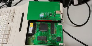

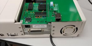

I did do a entirely integrated plus card for 2017's Tandy Assembly 1.0. Pictured here:
It uses Tomi's standard XT-IDE (Chuck Mod) Universal BIOS and works well. The circuitry on the rear of the board is a failed 1.0 attempt at an optimized version of Scott Baker's enhanced HardMPU so I could connect a MT-32. The 11th hour dead-bugging fix didn't work either. I need to respin the board to get it working but lost interest after life caught up post-Assembly.
The card on top is a first proof of concept at a NE2000 add-on for a future plus board design (this one is a stand-alone NIC). It 'works' - in that the packet driver loads, I get link auto-negotiation, and the NIC lights the activity LED when it sees 802.1 frames. But it never throws an interrupt on packet reception - not even broadcast frames. I had a small SMT EEPROM on the board for the NIC settings and MAC address. As I never could program it in-circuit, it go laborious de-soldering, reprogramming and remounting. So I decided to table it until I could respin the board for a DIP EEPROM I could easily experiment with.
I even had some success making a custom PLUS I/O bracket: (10 points if you can spot the brain-fart)

Heh. Eeguru, you put the RJ-45 on the wrong side of the board :P Now what's the hot-snot for? Did you make that bracket from scratch, or just modify an ISA bracket like I did? Either way, it looks well done! My thought was to have an appropriately sized PCB soldered on at a right angle (I've seen this done), but I'd have to do some testing to find out how strong it is in practice. Potentially, I could just get a local fab shop to do up a small sheet of 1.1mm steel on their CNC and bend the mounting tabs myself, but I'd want to have working boards before ordering that, especially if it's gonna cost money.
10 points!
A failed dead bug of a CPLD to replace the botched latches.
Milled from frontpanelexpress.com with the mounting stems bent up using a block-jig also from them.

ta6.jpgThe ATD T512CLK that I snagged from eBay (supposed to be Tandy compatible) doesn't appear to have those PLA chips, just 74xx series logic supporting the 8237A. Once it arrives, I'll reverse engineer that and compare the two. This board could also take a RTC chip, which must have been convenient. I had to perform "surgery" on the Smartwatch chip on my HX when it's batteries finally died. It had been slowly loosing time over the past 5 years or so (that I had noticed anyways), but almost 30 years of service before the batteries died completely is pretty impressive for a device that was only guaranteed to work reliably for 10!
