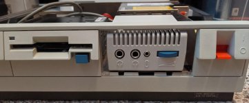

For anyone interested, this is what the speaker actually looks like in a Model 30:
As you can see, it's smaller than the standard PS/2 face plate by quite a bit. Pretty weird - does anyone know if there is different PS/2 model with SMALLER bays this would fit into instead? I'm really not sure what the point of the underside rails and clip are, otherwise.
