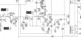

Hello,
So I have this IBM 5153 color monitor and the first time I tried to turn it on,
It didn't work. Not even the power light turned on.
There was a pop in the power supply so I replaced the power transistor and
a large concrete resistor that measured no resistance value(even though it was like 10ohm
or something).
The monitor still didn't turn on.
If I had a schematic, maybe I could trace the LED back until I find the problem.
I dont have a schematic though, could somebody please help me out here?
Some of the diodes looked a little corroded but measure fine while in the board.
Maybe I need to take them out and then test them?
Any help would be much appreciated!

The Power LED is hardwired into the main board. I don't think it would have anything to do with the crt because if it were broken the power LED would at least light up.
CRT broken? Perhaps check that the filament is on.
Look where the LED is wired, the secondary of the flyback, and note that it requires the HOT to be running.
Is the PS output stable despite the monitor not working? If yes, have you checked through the troubleshooting information provided so far?
If the PS output shuts off, start by changing out this 47uF cap in the PS per the attached image.

Horizontal Output Transistor, but close enough! Q403 on schematic. The LED is smack in the middle of the first page schematic in the SAMs manual, which is why it's so hard to locate.
If the tube neck is warm after a half hour the filament is almost certainly working.
Doh !
Has a thorough visual inspection been done? That can sometimes save a lot of effort.
From my reading of the circuit diagram in the SAMS document, there are two sources of 12V, and the LED is powered from the second.
1. 12V derived from 115V (on the diagram, the "12.76V SOURCE" square with 5 in it)
2. 12V derived from a coil in the flyback transformer (on the diagram, the "12.76V SOURCE" square with 9 in it)
The voltage for the CRT filament also derives from a coil in the flyback transformer.

So the HOT has 2 pins and an outer shell.
The outer shell measures 115v
while neither of the pins measure anything.
Would this be the problem?

BTW don't measure the collector of the HOT with your meter (metal outer shell you describe) because it has like a 800 volt pulse which could fry your meter but since you have no voltage on the base or emitter (the 2 pins) you
have no horizontal drive so only 115VDC on the collector. Check voltages on Q401. Lead labeled C should have 54V, B .32V, E 0V

Sounds like your HOT could be fried. You might want to check it out of circuit with an ohmmeter rather than risk your health with the voltages present.

So I measured my power supply again and it measures 127 now for some reason.
Does this mean something has broken, consuming less power?
Also, I followed the Collector of Q401 to T401.
One end of the coil is connected to the 127v
while the other end is 0v.
This is a faulty transformer, correct?
But does this explain the 0v at the base?
Also, would this affect the power LED?

If the horizontal output section is not running, there is essentially an open load on the power supply so I wouldn't be concerned the 115V is high. T401 primary should be 91 ohms. Either it is open and / or Q401 is shorted.
Yes, with no horizontal drive from Q401, the B of Q403 HOT would be 0. I am using SAMS CMT4-2 which is available online.
PS - the power led is driven from the horizontal output transformer which is dead at this point

First, the HOT is Q403. The SAMs schematic has the voltages at each terminal of that and Q401.
The power supply should be stable at 115 +/- 1 VDC. You can adjust it with an insulated trimpot screwdriver, but it must be under load, which it probably isn't right now.
It's hard to diagnose this logically from your responses. I would suggest doing preliminary checking with the power off. 2k ohms range for the two transistors.

Yes I get 0v on the 2 pins of the HOT and all three pins of the Q401.
Sorry for not being clear. I'll try better
I think the coil of T401 that connects to Q401 is disconnected because I measure no
connectivity between the 2 pins of T401.
Also, would a broken horizontal drive also cause the filament not to light?

yes the filament is fed by the flyback transformer, so no horizontal drive, no filament. Unsolder T401 and see if there is corrosion on the leads. The coil wires will be soldered to the leads that goes thru the board. Maybe you'll get lucky and find the break.
I doubt you'll be able to source a new transformer.
PS - or even apply heat/solder to the leads when it's off the board. It might heal the connection. Don't heat too long, however.
