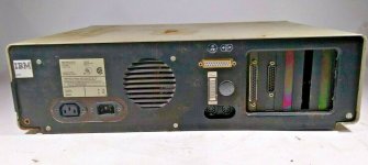

IBM PC 5150 Rev.A (Early S/N : 0101876)
What a narly looking scsi cable lol but awesome find! 👍 Mhmmmm cassette interface... Wish I never sold mine. At least I still have my 5160 and 5162 mutant. =)
Sadly I think one of the 2 is gonna have to go next year. Tryin to declutter my life mostly to whats important. I hoarded way too much stuff. Still looking for a 5151 monitor though.
