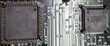

Hello, I've come into possession of a NEC PowerMateSX. Pretty much a dumpster rescue. Unfortunately the machine has been stripped of all it's cards so I'm looking around at the available video cards on ebay etc. I used to work on these types of machines back in the day, but it's been awhile, would you say any old ISA video card would do? Or is there some NEC voodoo to be wary of? Thanks for your help.

My concern for you would be that it looks like it requires a RAM board that isn't in that system, based on the second link that Alex posted, and also the weird first slot. I'd expect a 386SX to use a 16bit memory card though, just like a 286, so maybe the RAM board isn't proprietary? Sometimes 386DX machines used special 32 bit memory cards. Can you tell if any of the chips on the motherboard are RAM?
jafir you raise a great point. I've been reading over the other PowerMate threads on the forum and it never occurred to me that the RAM isn't on the motherboard, and this daughterboard didn't come with my system! My "spidey-senses" kept going off about ram, but I didn't piece that together until you said so.

Now I'm not so sure, because I do see something that looks like ram on the mobo (upper right-hand corner):
And here's the daughtercard:
Likely any "generic' EGA/VGA would work, at least to see if it would boot. But given that it was a salvage machine, I'd have a good check of the P/S before I'd even try that. Then check out that nothing is an issue on the MoBo. All you need to boot is (working) RAM and a way to output data (video). I'd suspect even then it's gonna complain about something... likely CMOS configuration and dead battery.
