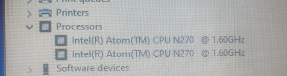

OK so I managed to escape from my grandkids long enough to snap the bottom label and Hardware Manager. It has 1gb or RAM and an Atom N270 CPU which is a single core multi-threaded CPU. NAFF by any standards.....
That processor is very similar to my N455. But it is lower power and does not support 64-bit. It also does not have an integrated GPU.
The 32-bit version of antiX or Debian should work fine. But make sure to use a Window Manager instead of the DE (like KDE or XFCE). (antiX defaults to IceWM, but Debian may default to KDE. I would use antiX) And antiX will run in memory even with only 1GB of RAM. It is remarkably light on RAM.
