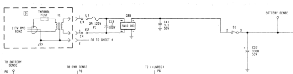

Unfortunately, the power supply aka wall transformer is missing. I plan to build a replacement power supply myself using a bell transformer with 24VAC output. Sufficiently powerful 20V transformers are quite rare here in Germany. What do you think?
Fortunately, the schematics for the wall transformer are given in the manual, section 7:
One thing I did not found out is the type of connector used on the far end of the wall transformer's cable to the teletype. It is a 3 pin connector - female. According to my measurements the spacing between the pins is almost 4 mm. The diameter of the pins is ~ 1.3 mm:
The connector type from the 703 model should be the same as for the 707.
Does anyone know the connector type?
