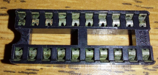

Everything came back to clean enough to make good contact except for the socket at U55, holding some kind of PAL chip, which itself cleaned up with mild sanding.
I don't have the greatest setup for de-soldering multi-pin stuff like this DIP-20 socket and wasn't looking forward to futzing about with de-soldering braid.
Then I had an idea, I could cut it free and then pull one pin at a time! Using an old/dull/broken Stanley razor utility blade, I cut the pins between socket and board.
(bent/rusty pin I found in the shed works great to pull out the bad contacts in the socket!)
Worked great! I can even clean and repopulate this socket with new pins/receivers since it's intact and I have a bunch of used pins from sockets where the plastic melted when I salvaged them from junk boards. Sure, sockets don't cost much, but I'm currently working on a zero-cost budget until I get a job again. And it's fun!
