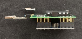

Here is another small 68000. Instead of FPGA, I found an inexpensive (<$10) CPLD development board based on EPM240 on eBay. I have designed a series of retro computer mezzanine boards (Z80, Z180, 6502, 68000) to plug on top of the EPM240 dev board. Pictures show the eBay's EPM240 dev board (blue board) and the 68SEC000 mezannine board. The mezzanine board has 1meg of RAM, SD card, I2C, and serial port. EPM240 dev board provides the bootstrap ROM, serial port, and glue logic. The design runs on 16. 7MHz, 3.3V.
