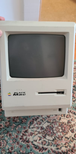

does anyone know anything about this Mac pc... the front has The Black Mac.. and thats all i know about it.. cant seem to find any info on the net at all..
Looks like a regular early model Mac (128, 512, or Plus) Something when addon boards or accellerators were installed they would put a sticker on the front. So I guess opening it up to see if it has an addon board is your next bet.
Mostly likely someone just put a sticker on it. The serial number should be on the bottom lip next to the brightness knob and/or on the back. You can lookup your system here: https://everymac.com/ultimate-mac-lookup/
Where's the picture coming from? If this is from you, just open the Mac and look inside. There's most likely some 3rd-party add-on explaining why it is named that way.
If the picture is not yours, ask whoever made it for details.
The term Black Mac was used to refer to the famous Tempest Mac which has a cover plate over the floppy drive. The unit pictured is not that.
The sticker might indicate the company that owned it but finding a company that used block italics for its logo will be a challenge.
i dont have the unit as of yet its coming.. this was from an estate sale and the guy had a wall of macs but this and a Black version stood out so i got them both.. i'm not into mac's but it got me looking at these 2.. will update when i get them and open them up..
