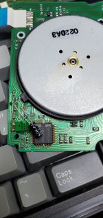

I thought I was on to something. The short version of the story is I found a tantalum capacitor on the motherboard that was shorting the -12V to ground. I replaced the tantalum with an electrolytic. The voltage is now steady at -12V but as before, the floppy drive still does not work properly. The disk turns, the red light comes on, and the head can move. But the computer fails to read, or boot from the floppy. I eventually get the famous Abort, Retry, Fail error. I tried to format a disk and I got a "Drive Not Ready" error. At some point during my testing, I did get a "Failure on Int24" error. It seems replacing the cap made no difference.

You should take a look at the electrolytic caps on the bottom of the fdd. I've found these can sometimes go bad in many of the toshiba t series. They don't always leak but replacing them has repaired a couple of them (including in T3200's)
Well, it was a valiant attempt. I think I damaged this beyond repair. I only saw a single 4.7uf cap on the bottom of the FDD. I removed it and replaced the SMD type with a radial leaded cap from a capacitor kit I have. I did a temporary solder job just to see if it would work. I didn't see the magnetic (nub) on the "wheel." I powered up the computer, let it boot, put in a disk, and pressed "a:" The nub came around and ripped the cap and the trace from the board. That trace does a "Y" split and one side goes under the "wheel". I do not know what it connects to.
In disassembling the FDD more, I see a couple more electrolytic caps on the other side of the board that were hidden from view. But it's probably a moot point since the trace has been ripped from the board.
Anybody have ideas or a source for older 26 pin, 1.44MB floppy drives?
Thank you for the suggestion about the caps. I bought another broken T-3200 from eBay to use it for the floppy drive. I pulled the drive from the broken computer and put it in the target. The floppy drive did not work. I could tell it was trying harder to read the disk before giving up. But it would fail.
The circuit board in the new floppy drive is a different version. The short version of a long story it the 6V 22uF power supply caps were still good. The polarized 16V 10uF filter caps near the motor driver were both bad. I ordered totally wrong replacement caps from Mouser, installed them thinking they were the correct parts, and the floppy drive is reading disks! :) Yay!!!
It wasn't until afterwards that i compared before and after pictures and saw I did things totally wrong!
It looks like I'll be ordering some more (correct) parts). 😂
A word of warning though, they are SMT. So you might have break out your SMT skills for these.

Hey @shawnerz that's a great find 🤓 it could potentially help fix all the other busted floppy drives from the T3200/SX/T5200 era - a real plague of failed FDDs.
Do you know the model of your drive? And what cap numbers (on the board) were they?
For example, I'm aware of 2 types of FDD in the T5200, a Toshiba ND-356S-A and a Citizen 0SDA-32C.
