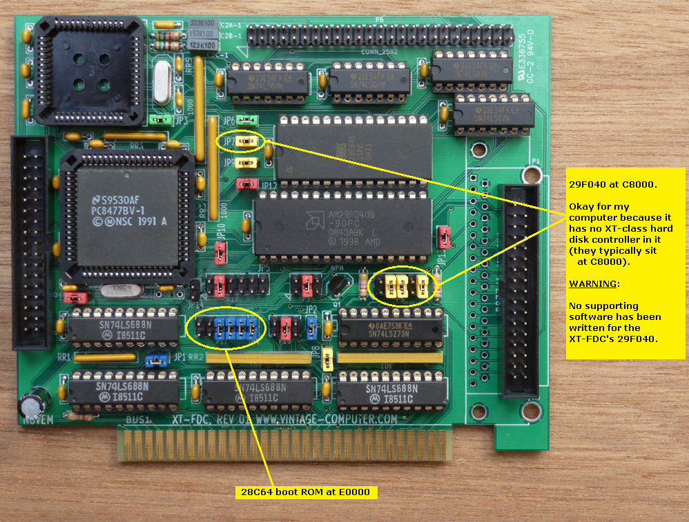

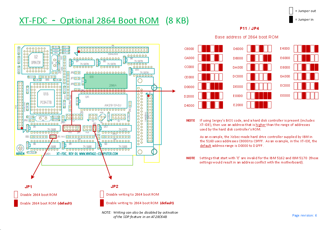

3. Optional boot ROM.

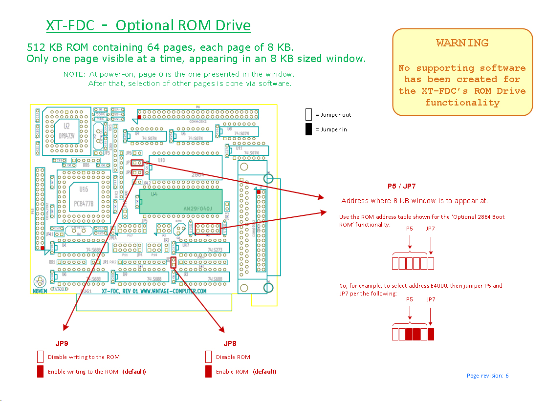

4. Optional ROM drive (MAY13: No supporting software - none currently planned).

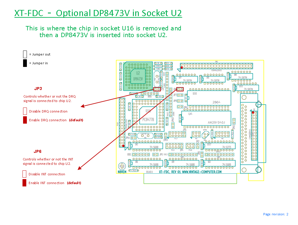

6. Optional use of a DP8473V controller chip in socket U2 instead of a PC8477B controller chip in socket U16.

2. National Semiconductor DP8473V
Nothing in socket U16, and a DP8473V in socket U2.

Separate jumper diagrams have been created for the four major functionalities.
1. Basic FDC
2. Boot ROM
3. ROM drive
4. DP8473V in socket U2

#  PART 2 - OPTIONAL FUNCTIONALITY - SECONDARY INTERNAL CONNECTOR (P2)
PREREQUISITE: The 'Basic FDC' functionality (per part 1) is fitted.
NOTE: Used for third and fourth drive.
WARNING: Cannot be fitted if the optional 37 pin external connector (J1) is fitted.
Qty  Designation/s       Description                                     Example source
1    P2                  34 pin header (for 5.25" floppy cable)          eBay item 270983313975
1    JP12                Jumper block - single position                  eBay item 261019628248 [cut to size as required]
#  PART 3 - OPTIONAL FUNCTIONALITY - BOOT ROM
1    RR2                 Resistor network - SIL - pin 1 common - 10 pin - 10K  Mouser part: 652-4610X-101-10K    Bournes (maker) part: 4610X-101-103
3    JP1/JP2/JP4         Jumper block - single position                        eBay item 261019628248 [cut to size as required]
1    P11                 Jumper block - 5 positions                            eBay item 261019628248 [cut to size as required]
1    U9                  74LS688 (e.g. SN74LS688N)                             Mouser part: 595-SN74LS688N
1    U10                 2864                                                  Recommend Amtel AT28C64B  [note the "B" suffix]
2    [note 1]            Capacitor, ceramic, 0.1 uF                            eBay item 390497290180
1    -                   IC socket - Narrow DIL - 20 pin (for U9)              "Narrow" = 0.3" width - eBay item 181052426378 [note: 24 pieces]
1    -                   IC socket - Wide DIL - 28 pin   (for U10)             "Wide" = 0.6" width - eBay item 200853526558 [note: 17 pieces]
NOTE 1:
   0.1 uF supporting U9 = C16
   0.1 uF supporting U10 = C4
#  PART 4 - OPTIONAL FUNCTIONALITY - ROM DRIVE
WARNING: No software yet written to support this optional component. None currently planned.
PREREQUISITE: One of the following two items is in place:
              1. The 'Basic FDC' functionality (per part 1) is fitted; or
              2. U6, JP14, R5 (used to generate the CD_FDC signal fed to chip U1)
2    R3/R4               4.7 K ohm, quarter watt
1    RR4                 Resistor network - SIL - pin 1 common - 10 pin - 10K  Mouser part: 652-4610X-101-10K    Bournes (maker) part: 4610X-101-103
3    JP7/JP8/JP9         Jumper block - single position                        eBay item 261019628248 [cut to size as required]
1    P5                  Jumper block - 5 positions                            eBay item 261019628248 [cut to size as required]
2    U1/U3               74LS688 (e.g. SN74LS688N)                             Mouser part: 595-SN74LS688N
1    U17                 74LS273 (e.g. SN74LS273N)                             Mouser part: 595-SN74LS273N
1    U4                  AM29F040B  (DIL version)                              eBay item 140891844317 [note: 2 pieces]
4    [note 1]            Capacitor, ceramic, 0.1 uF                            eBay item 390497290180
3    -                   IC socket - Narrow DIL - 20 pin (for U1/U3/U17)       "Narrow" = 0.3" width - eBay item 181052426378 [note: 24 pieces]
1    -                   IC socket - Wide DIL - 32 pin   (for U4)              "Wide" = 0.6" width - eBay item 150964290385 [note: 15 pieces]
1    Q1                  Transistor, 2N3904, in TO-92 package                  eBay item 271098898259 [that eBay item is for 50 pieces]
NOTE 1:
   0.1 uF supporting U1 = C18
   0.1 uF supporting U3 = C5
   0.1 uF supporting U4 = C2
   0.1 uF supporting U17 = C17

#  PART 7 - OPTIONAL USE OF DP8473V INSTEAD OF PC8477BV-1 (i.e. remove DP8473V from socket U16 and place a DP8473V at socket U2)
1    C1                  Capacitor, 510 pF                               Mouser part: 581-SR205A511JAR
4    C14/C15             Capacitor, 10 pF                                Mouser part: 581-SR151A100KAR
1    C21                 Capacitor, 1000 pF                              Mouser part: 581-SR201A102KAR
1    C2A-1               Capacitor, 0.033 uF
1    C2B-1               Capacitor, 0.015 uF
1    C2C-1               Capacitor, 0.012 uF
3    [note 1]            Capacitor, ceramic, 0.1 uF                            eBay item 390497290180
1    X2                  Crystal 24 MHz                                  Mouser part: 717-9B-24.000MEEJ-B    [this works on my prototype #1 card]
2    JP3/JP6             Jumper block - single position                  eBay item 261019628248 [cut to size as required]
1    R1                  5.6 K ohm, quarter watt
1    R2                  560 ohm, quarter watt
NOTE 1:
   0.1 uF supporting U2 = C19/C20/C22
