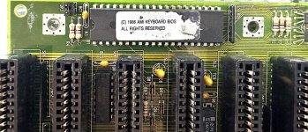

Hello, I hope someone can help! I've scoured the net looking for my board but can't find the company, so It's probably one of those "unknowns."
It had Varta damage when I got it, but I got it cleaned up and replaced a few caps that were Varta damaged. On first boot I kept getting the three beep memory errors.
After inspection, I noticed tha I had some issues with a couple of pins in the sim sockets, but got those straightened out - and no more beeping.
Now when I apply power I get the video card screen, then the initial Bios screen telling me to press del to enter the bios.
Pressing del does nothing - in fact, on two different LCD monitors I get a message that says "out of range" (I think it's related to the 720x400).
I've tried a Cirrus VGA card and it does the same thing. I've tried a CRT VGA monitor and it doesn't help. Used an AT keyboard and a PS/2 with AT adapter.
Tried removing the "display" jumper" and resetting the bios as well by shorting the pins (correct?)
I've tried just about everything I can think of... The Analyzer card says "8382" and no beeping.
If it were in a crashed state would the analyzer card do anything different?
Any ideas?? Things to test?
One odd thing - one of the jumpers has a setting for 66M or 80M. Don't know what that's for. Can't imagine it's mhz??

The pictures are low quality JPEG so it's hard to tell, but it looks like there's more trace damage that wasn't repaired.
You may also want to check VIAs in that area, battery corrosion often destroys them.

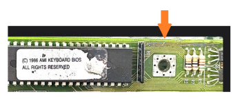

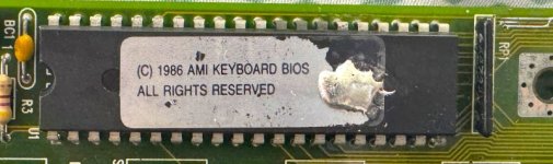

Here's my keyboard bios with a blob of solder on top? It's down on the opposite side of the board from where the Varta was.
Is the solder there for a reason?

Yep. just noticed that! I fixed it and got further - now I get to CMOS settings not set Press F1 to continue,
Tried two both AT and adapted PS/2 and no go.
Joe
I agree with Svenska. There could be one or more damaged tracks (relating to keyboard functionality) that you have yet to discover.
