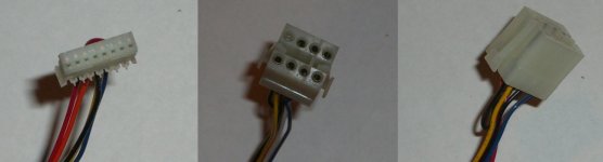

Ok several things. There is no five pin header anywhere on the thing. The jack is for the PC speaker. Believe it or not, the Keeper II is not dead! The other white little switch next to it is a reset button. BIOS is dated 1988. OF the four DIP switches, 2 and 3 are set to off and the others are on. It booted fine but couldn't detect the keyboard (or a drive).
I did look on Statson and found that card, but that's not it - it is totally different.
Oddly, the eight pin header has a cable that terminates into what I can only describe as a dual 4-pin molex with locking latches. I figured it was power relatated.

Ok, I managed to take those pictures. The cord is only a foot long or so.
Let me know what you think.

On the component side of the board, under the label, I'm wondering if that might be a keyboard controller. Can you make out any part numbers on it ?

This is why I was curious to see if the upper-right hand, taped over chip might not be a keyboard controller, because then we can see if pins 4 & 5 go there.
At first glance I thought pin 4 wasn't connected on the connector, but on second look, I think I can see a white wire lurking in one of the pictures.

I tested the pins with a multimeter. On the eight pin connector I am assuming that pin 1 is actually the rightmost one based on the orientation of my pictures.
If this assumption is correct then:
Pin 2 is +5V
Pin 7 is ground
Pin 4 connects to pin 22 on the right uppermost IC
Pin 5 connects to pin 1 on the right uppermost IC
That upper-rightmost IC is covered by the label but part of it reads ...08742 7490141 Intel '82
You might want to try re-seating the IC. Probably won't do anything, but simple enough to try.
Out of curiosity, is there a bump underneath the paper (I'm wondering if there's a window there) If no bump( window ), could you peel back the label a bit more to see if there's a recognizable part number ?
