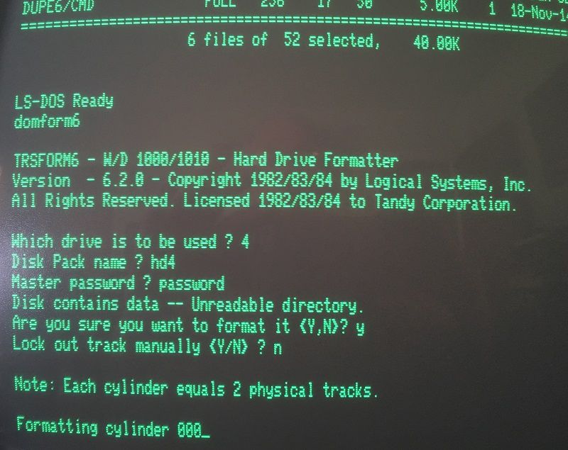

Thanks, Hans01 of the Netherlands ;) for the jumper info. Jumper 3 installed on the Hans-02 and jumper 1 is removed from Lo-Tech. Progress is (sort of) being made.
The PQI Industrial 128MB DOM fails here:
and here:
However, substituting a completely inappropriate Kingston Industrial 8GB DOM, it fails here:
with the Lo-Tech Act. light lit.
And substituting a 512kB CD card and using LSDOS620.IMD and the TRSHD2/DT and TRSFORM2/CMD it gets this far into "verifying" and bad format before it quits:
The Hans-02 is talking to the Lo-Tech and the Lo-Tech is talking to the media.
Seems to me that the PQI 128MB DOM is bad??? If I install it as hard drive 2 behind an IDE HD, is there anything I can to fix it?

First remove old info:
SYSGEN NO
AUTO
SYSGEN
Reboot
System (drive=4,disable,driver="DOM6/DRV")
Select 1
heads 8
tracks 203
heads / partition 2
start 1
Repeat for drive 5, 6, 7
Format 4, 5, 6, 7
If there is still an error on the DOM, than the DOM is bad.

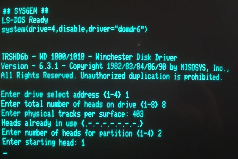

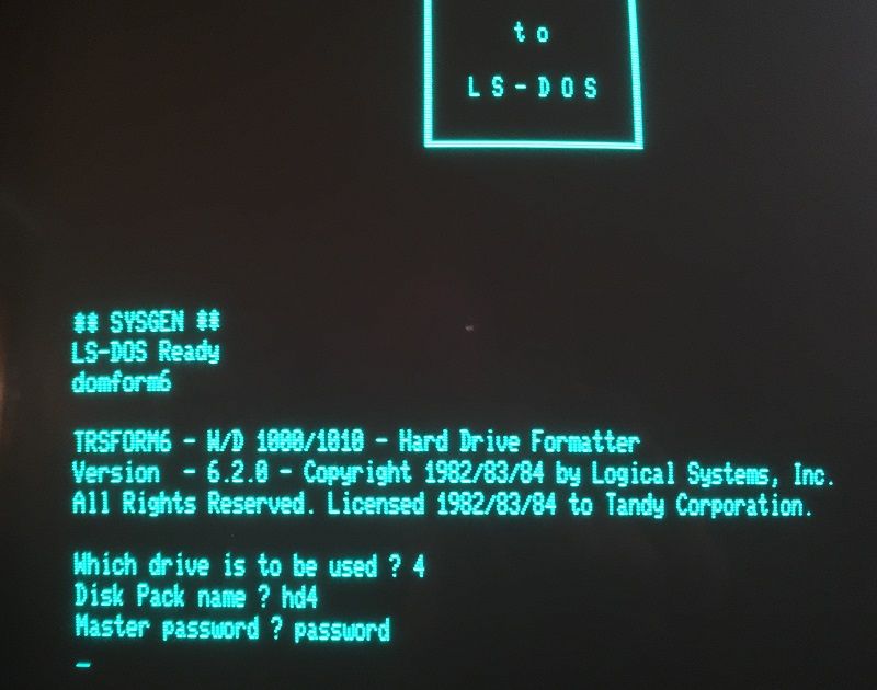

Mike:
Try to remove the drivers from the boot disk:
System (drive=4,disable)
System (drive=5,disable)
System (drive=6,disable)
System (drive=7,disable)
Now setup the drivers
system(drive=4,enable,driver="DOM6/DRV")
etc.
That's what I was doing in the second picture above. It locks up after entering the starting head. If I leave your sysgen'd drives, it locks up after entering "password" (1st pic above).
