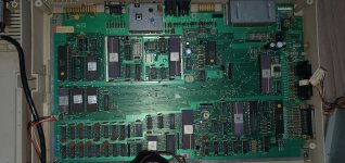

Like Richard, I had no idea what I was buying. I took it home, opened it and started to research based on what I saw. That's how I got here. It does indeed appear to be a preproduction 128D, 120V and NTSC. Board S/N: 129. As previously noted there is no sticker on the case itself. I've sent pictures off to Bil Herd who did respond. He believes it is a pre-FCC / pre-production machine possibly assembled as a demo for CES (or World of Commodore?) I have found a YouTube video of a similar board S/N: 323, but assembled as a standard C128. However I see some differences even between that one and mine. It was likely still evolving at that point. You can view the video here:

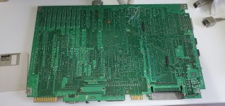

The artwork rev # printed to the boards does not correlate with the actual working rev # Bill tells me. The back of this board is printed artwork "REV 3" and there is a s/n 129 on the topside of the board. He recalls they took "rev 6" boards to CES. An actual "rev 3" did not even have a working Z80 yet. There are quite a few jumper wires on the backside of the board. I have taken the machine apart to clean and repair. While it is apart I am photographing and documenting as much as possible. Although Richard did post it was working back in 2019 there are some broken wires going to the drive logic board and a broken drive mechanism. It does boot into both 128 and 64 mode. Once I repair the drive I will do further testing including CP/M. The drive board appears to be a standard 1571 board stuffed into the machine with wires hand soldered to a connector for the main board. All of the C128 specific chips are ceramic, while the others either have 1984 or 1985 production dates which would indicate they are original for the time of production. The case is far from perfect and indicates it certainly got quite a bit of use at some point in it's life. Possibly travelling as a demo unit? It would also make sense that Commodore likely sent demo units out to software developers early. So maybe that is another reason it was built? If anyone is interested in hi-res pics of the board send me your email.
I feel extremely privileged to own this piece of 128 history and look forward to discovering more about it. I've been a C128 enthusiast since a kid when I purchased one with my paper route money. Anyone with more info or leads to more info, it would be appreciated if you could message me. I am not able to make VCF East or I would bring it with me to display.[/MEDIA]
