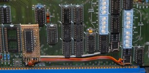

I solved my address decoding problem with the TurnKey board.:D
Without destroying my original, i looked for an way to get the lower 8 address bits decoded for the SenseSwitch.
The addresses A0-A7 are available from the EPROM sockets, so i create an adapter to get these.
With an 74LS133 (NAND with 13 inputs) i decode 0FFH from A0-A7 and INP for the SenseSwitch.
Then i route three wires to the original decoder K (74LS30) and feed it there in.
These modifications are fully reversible.

The second version of the TurnKey board I/O decoder i realize with an 16V8 GAL, because i want decode two I/O devices.
The sense switch on the board requires the address 0FFH and the ACIA 6850 two addresses (in my case 10H,11H).
The GAL 16V8 gives my free pin assignment and both addresses in one package.
