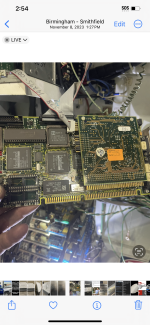

Larry here are some pictures of what I am dealing with do you think if the real time clock battery is bad it could cause the following ?
After sitting and me working with it I power it on and it starts to power up and boot but the screen flashes on and off and only stays on a short time. If you reboot again you get nothing.

After seeing all these Pictures of the backplane and all the Tantalum Capacitors
it makes wonder if one of those could be pulling one of the power supply
voltages down, but not shorted.
When it is testing Memory and the message "PRESS ESC to ABORT", if you do nothing,
how long will the memory test run? Does it die quickly or does it run for a while?
If you have access to a DC Clamp on Amp meter, you could check the current during startup
and see if when it quits the current increases to the point where the Power Supply shuts down.
Do this for +5, +12, -12 and -5 as required.
Other than that, it's going to be a guessing game as to what is causing the problem.

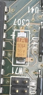

I was going through the board and I found that three of these show continuity and the rest don’t ? Can you explain to me what they are and should they show continuity or not ?
That's a tantalum capacitor I believe. Usually used near (electrical) noise sensitve ICs, connected between the incoming power and ground. Should not be shorted, but that's the common failure mode.
Hi Larry
What type of continuity tester are you using?
It's possible something else in the circuit is triggering the continuity tester.
Try testing continuity in both directions - swap the sides the probes are touching.
Ok after checking all the capacitors I found two that I believe to be shorted. I attached a picture of the two shorted ones. of how There was also one on the back side of the motherboard near where the power supply plugs in. Is there any diagrams available for this board to see where these capacitors go and if they can be causing my issue of no signal to the monitor? The one on the motherboard I marked with a X and the two on the board I believe to be c300 and c307IMG_8223.jpegIMG_8226.jpegIMG_8225.jpeg
