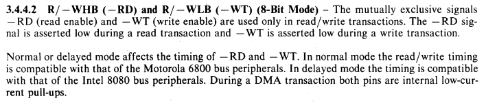

Hi, I made a PCB back in 2015, and re-sold several of them to various folks. Some were "kits" of parts to stuff the board with. I kept two for myself. I sent my version of FigFORTH on an EEPROM. Here's a pic of the assembled board.
BTW, you may recall that there was an issue with flakey behavior related to the MC6850 UART. I believe I have a firmware "fix", if you're interested.
Pete
Pete,
Yes, I have that board. I would like to apply the fix and get it running again.
I’ll send a PM with my email so’s to not drag this further offbase. Looking forward to ODT progress!
-C
Pete: Could you send me a copy of the "fix" as well? Thank you. - paul
Just now sent info and code to the email indicated by your forum name.
For other's interest, here is a description of the solution:
My *belief* is that the UART issue was when the code would test the Receive Ready (or Transmit Ready) bit before sending/receiving a byte. The T-11's bus behavior of "read before write" and such confused things for the UART.
I set up a receive interrupt, so that testing the Receive Ready bit is never needed. Received chars go into a small buffer, and Forth pulls chars from that buffer.
For Transmit, there is a fixed time delay to wait for the UART to finish sending (not efficient, but simple and effective).
With these changes, I can no longer reproduce any problems.
maybe it's worth trying to change bit 1 and/or bit 8 (Mode Register) when the processor starts?
or consider this:
Yep, did all those experiments in various combinations years ago.
Setting those mode bits to match the HW config is required at every power-up. My "sandbox system" has DIP switches to make it real easy to try different things.
The fix I described with adding Receive interrupt support is easy, and is really much better overall, since the original Forth system POLLED for incoming chars which makes it hard to run any sort of 'background task'. And my newer code also uses the Receive interrupt to test for an ESC char, which is used to break out of a running task and warm-start the system. Real basic OS stuff.
It should also be possible to avoid the UART issue by adding some HW logic in the Chip Select area, but I never tried it.
Pete
