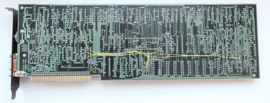

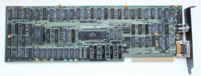

Very early IBM CGA with date 44/81 added by me

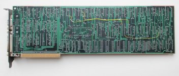

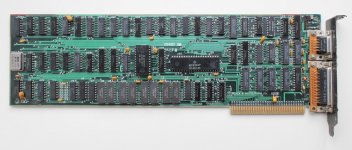

Early IBM MDA card with date 08/82 added by me

And the early MDA card revision that one can hook to an RGB Multisync and mysteriously get high-resolution color text.
Yes, this works fine on multisynch RGB monitor, I tried it some time ago :)
What multisynch monitor it require? Would it work with non org. MDA cards that have similar looking pins on board?
I am using TVM color monitor, it must be monitor for MDA/CGA/EGA modes. Works only with first revisions of MDA cards, with black sheet, or modified newer card.
