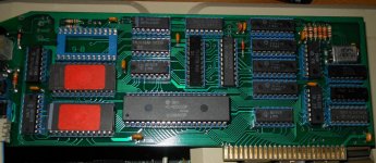

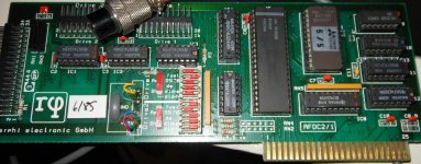

I've made some better pics of the two cards I can't really figure out what they do, and the mainboard.
I couldn't find any Rev number near slot 4 - but I saw I made a mistake with the handwritten sticker - it seems to read 7921 instead of 7912.
Not sure what that means.
Yes, the yellow cables go to a connector for the lcd screen. The white ones on the right just seem to provide external connectors for the speaker.

If you pull the 6502 CPU chip, the revision number should be printed underneath it. I'm pretty sure it's earlier than rev. 4 if it doesn't have the revision near slot 4.
Careful prying with a small flat screwdriver from each end, a bit at a time, seems to be the safest way to pull the 40 pin DIP CPUs.
The 03 in the part number shows it's a rev 3 board.
That's a pretty amazing LCD interface setup, I've seen a few mods on Apple ][s, but yours has to be one of the most modified I've seen.
