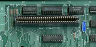

Here's the first problem I want to fix, which is the busted AUX connector. Since everything else on the board works, just this one thing needs to be done:
I have read up on soldering and desoldering. It doesn't seem like it will be too hard with the right tools. It's simply a matter of sucking the solder off the 30 pins on the connector, then putting new solder on the replacement part, as far as I can tell. I'm just worried there's something else involved that I'm missing. I can swap components all day, but I have never really messed around with component-level repair.
You're right as far as what needs to be done. Have you soldered before? If so you should be fine for the most part. The hardest part would be 1. being careful with your desoldering not to damage the board (too much heat too long) and the accuracy to resolder the pins without shorting out your solder joints. If you've done all this before then you should be good to go. If not then I would highly recommend taking a scrap board or item and learning/practicing on that first.
I have soldered before, but only to install components. I don't have any real experience desoldering. I was planning to do as you say and try it first on a junk board.
