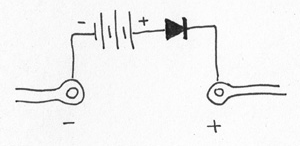

It's just a 6V non-rechargeable battery, so with some cutting and soldering, you might have the option of running a lead to outside of the computer, with pretty much, any 6V non-rechargeable battery (or battery pack) at the cable end.

so if its non rechargeable (I assumed it was a rechargeable battery) Cant I use a couple CR2032 cells in series?
so if its non rechargeable (I assumed it was a rechargeable battery) ...
"Lithium", so non-rechargeable.
Possibly. When batteries are new (or fully charged in the case of rechargeables), they measure something over the nominal voltage. So a question becomes, is the amount-of-voltage-more-than-nominal-value going to be a problem for the particular equipment? For example, I just now measured a new CR2032 battery. It measures 3.3V, so is 6.6V going to be an over-voltage problem for the P70? I don't know. Maybe the IBM supplied 6V battery was just as high when it was new. If you feel uncomfortable about the situation, you could put in a 1N4148 diode in series to knock the voltage down a little.

Unfortunately I used my last 1n4148 and tried using some 1n270's but that pretty much lost all the voltage. I just put in an order for some 1n4148 diodes. Thank you for the input! This is good news!
Yes. Went over it several times. I ended up gettting less than 1v. But ordered new diodes so will go over them again.

So my leads I bought online came in: https://www.ebay.com/itm/254628295576
I measured the voltage and was getting 6.1V. I decided not to use a diode as I figured it would be closer to 6.4V and it wasnt. I connected it up. Changed the settings, Date and Time. Powered it down and unplugged it for 40 minutes. And when I boot it back up the settings retained. Seems to work fine.
