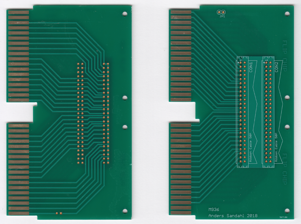

I need a pair of BC08H cables for expanding my pdp-8a omnibus. Are those hard to find? I have drawn a new set of boards that I intend to order if I can't get the real thing. Is there anybody that would be interested if I make some boards?
The boards that I plan to build uses regular flat cable instead of the flexprint cable that I can't find anywhere, just FFC cables which is much thinner and super expensive at long lengths (like 500mm) .

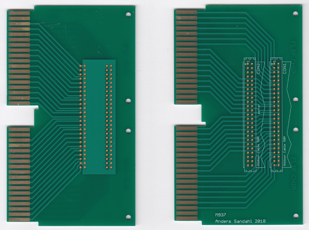

I have already ordered the boards and I made ten of each (M936/M937). To build one extension set two boards of each are needed. I'll keep at least 2 sets for myself, which means that there is one left.

The boards arrived today, this is what they look like. I have to order the components so I can built the cables. The card edges must be chamfered of manually.

Look good to me. Nice silkscreen! Hand-chamfering is a well-honed technology known to many of us :->.

Yes it would be possible. But this is not a project from me, to many other projects. But anyone can download thee gerbers: http://www.pdp-9.net/docs/BC08H/M936-gerber-rev1.zip and http://www.pdp-9.net/docs/BC08H/M937-gerber-rev1.zip

I like how you even put holes for mounting handles! The "FLIP CHIP" and M936 and M937 give them the look of authenticity.

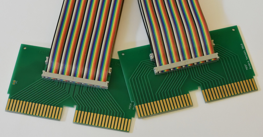

I'll order some cables and connectors and some other things that I need to finish the expansion box.

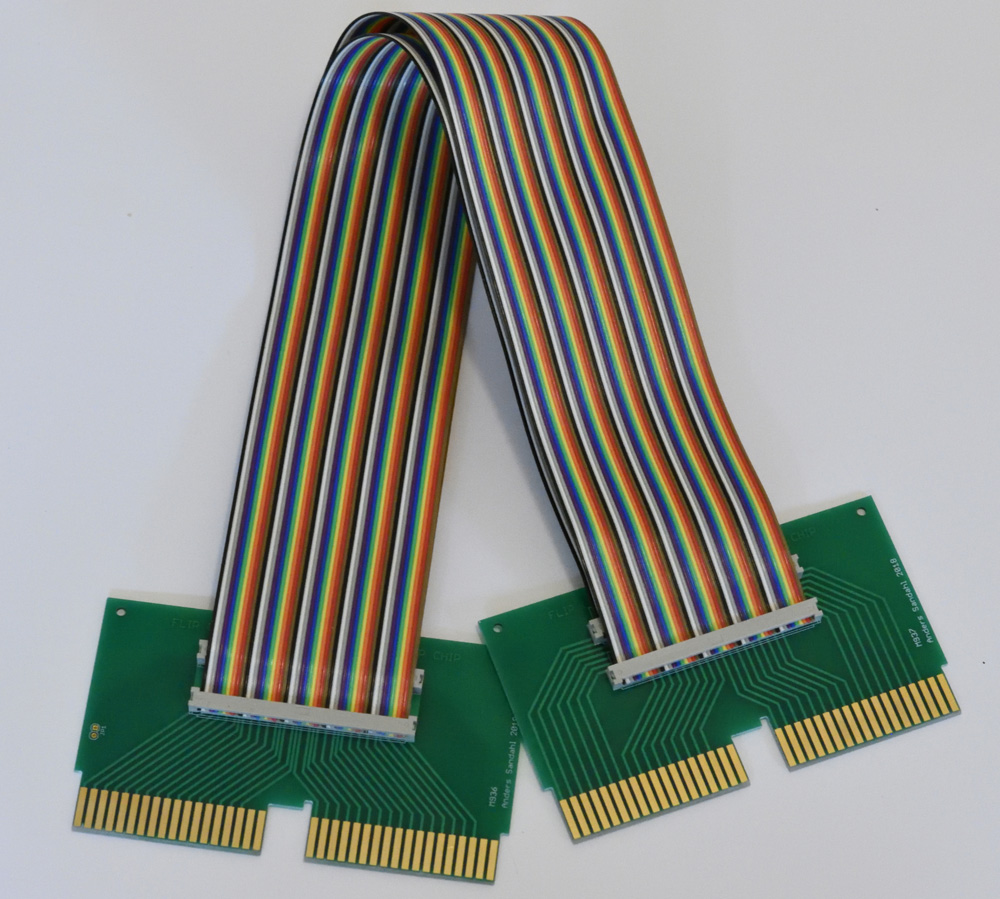

Haven't tested them yet. Don't know why, but I had only bought four PCB-flat cable connectors so I need four more to build the second cable. There is still some small work to do on the expansion box as well.
Ok, the cables are tested in together with my homebrewed expansion box. Works OK!
It's built from a PDP-8a/100 chassis with a 10-slot backplane. I had no regulator board for this so it's equipped with modern switch mode power supplies for 5V +15 and -15V (no new holes drilled). I had to build a very simple powergood circuit that holds down the signal in the backplane.
