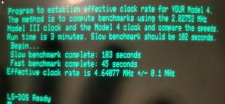

so tonight I opened one of the two "speedup kits" that I have acquired in a mix match box of parts.
this kit is simple, a board that will end up plugs into the Model 4 U3 and the U3 chip onto the board, and swapping out the Z80A (4mhz) for a Z80B (6mhz) CPU. simple… well, in reality, take a lot longer to take apart the computer internal to get to the mainboard than apply this kit. simple it IS!
NB: I have 150ns 4164 chips in the system already installed and strongly suggested to get good speeds 120ns would be better.

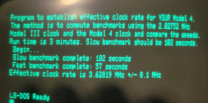

step one: I found a program called "clkspeed/cmd" for model 4 (runs on TRSDOS/LSDOS 6.x) and ran a benchmark to get an idea, 3 mins later the result was on the screen, 3.62Mhz at top speed.! with the Z80A stock from TRS.
turned off the machine, found the U3 chip, removed it carefully (notice some mod already one it) and put it on the alpha speedup board and reinserted the board in the place where the U3 was pulled from
Next, I replaced the z80a with the z80b that was provided in the kit
closed her up and ran again the same test and low and behold “speed”… Seriously, now calculations at 2 Mhz took 103 seconds, 57 seconds in 3.66 Mhz now barely take 45 seconds in 4.64Mhz ! the kit claim to fame only 5.x Mhz speeds, so I am close and better speed would be acquired with faster ram I am sure but happy anyway.
Maybe I should put a heatsink or a water cooling system. Kidding aside, 1Mhz was a lot in 1982, and at 65$ this kit WAS the easier and cheapest kit available on the market at the time.

I tracked the article that mentions for Model 4 NGA (not for 4GA models) motherboard that lifting the Pin 27 of the CPU would remove the wait states of the CPU (article can be see at https://archive.org/details/compute...lishing-aug-1993/page/8/mode/2up?q=z80+pin+27) so here we go , pulled the new Z80B chip and bent gently the 27th pin and then re-instated it back unto the board, after reassembly. ran clkspeed again so now from the base 3.66 to 5.17 Mhz ( +41.25% cpu speed increase) with a little kit and a bent pin.. still running 150ns chips as ram.

On the first issue of speeding up the system;
The FDC will be fine and trouble-free up to 6MHZ, at 8Mhz (z80H) there is a change that needs to be done (Seatronic's speedup board explains it) to permit no issues with the floppies.
The RS232 at 6-8Mhz is fine as it uses another control signal regimented at 5mhz anyways.
The wait state was only on the Older NGA boards (model 3/4) once the Gate array boards came out for the Model 4,4d,4p there were no more *wait* being used. and the reason why the pin 27 mod is only applicable to the NGA board, doing this on a GA board will just make the machine stop working entirely), but at 5MHZ there are no changes to be done elsewhere except 150ns 4164 DRAM
As for the RAM Speed not being a factor that also isn't accurate, 200ns, 150ns, 120ns, or 100ns speed of the ram, does matter if you are pushing 5Mhz and running 200ns you will encounter issues of course(lockups mostly), and that is why all speedup kits recommend 150ns up to 6mhz and 120-100 for the 8mhz kits.
