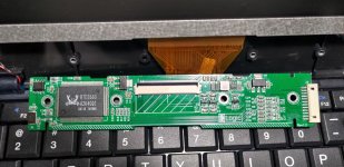

I received a new LCD controller as well and I was able to dump the firmware from both boards and I can confirm that a simple firmware transplant seems sufficient to fix the original board.
Unfortunately it was necessary to desolder both EEPROMs otherwise the TL866 complained about overcurrent when just clipped to the chip while on the board.
The boards are identical except for a slight difference in the main controller chips, the original is RTD2660 C3F62G1 while the new one is RTD2660 D8C23G3, I don't think it's particularly relevant.
The EEPROM is a P25Q40SH (4Mbit SPI) in both boards and it's not directly listed at least in the old MiniPro software, I selected more or less randomly the BG25Q40A and disabled the ID check and everything worked
I've decided to check if that solution is universal or not, as i presumed new RTD firmware is actually some generic VGA one without CGA support.
I was right - i flashed new fw to my V1 and LCD said "Not Support" after switching from dark brown to blue.
Dumped original beforehand - and it's identical to your board one.
Ah this is interesting, so basically with the VGA firmware the CGA card for the V2 wouldn't work?
It seems you can't have both CGA and VGA support, you have to pick one

My V2 Book with both cards yet to arrive, so i cannot directly confirm. There's a chance CLPD code for CGA was changed, but i doubt. Either way, switching board with card for CGA is not the worst solution :)

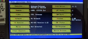

I cannot run any tests on that, but main problem reported for CGA firmware (dunno what correct name would be for that) is that it doesn't fully support standard VGA modes, resulting in black screen, for example mode 12h (640x480x16).
Can you check if that mode works on your Book with VGA?
Attached a quick program for that, sets mode 12h, prints strings, wait for keypress and sets original mode back.
I was able to run Windows 3.0a at 640x480 256 colors or even 800x600 256 colors using these drivers https://winworldpc.com/product/avga3-gd542x-display/1 and following the instructions in this readme https://web.archive.org/web/20150809205726/http://ftp.net.pulawy.pl/drivers/legacy/vga/cirrus/cirrus1/#1/win30/readme
Initially it seemed to not support 640x480 256 but it run at 800x600 256 however after using clmode (also included in the driver package) and enabling High VGA Refresh Rate it seemed to have fixed itself even after powering it off and on again

Tried this on V2 VGA: Black Screen. After the black screen.. I Ctrl-Alt-Del'd... and my A: drive (that I booted from previously) vanished in XTIDE and gave a General Failure in DOS.. lol.... YOU BROKE MY BOOK!! j/k not really, but you did nuke my USB stick until I power cycled... then it was back to fine. So that's a bit strange.
I did notice on the CGA that it's properly aligned during the actual bios POST, but the screen mode changes or something when the XTIDE banner comes up and then it's shifted..
@GizMo79 - Alas, i have no V2 book.
@sorphin - Book is not that easy to break :D Though it's strange drive A disappears - does it behave same way every time you do a Ctrl-Alt-Del reboot? That might be related memory not cleared of warm reboot.
That "VGA" message is from LCD controller, so does PALTSR3 work for you for text mode alignment? It's a bit unclear for me.
PALTSR3 switches off signal to LCD controller and returns it back after delay.
Black screen in mode 12h means just exact the thing - old/CGA LCD firmware doesn't support all VGA modes. But if that not needed - no need to do anything (i still think VGA is overkill for 8088, but i would love Tandy emulation there)
