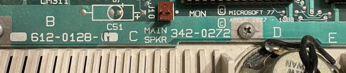

I bought an Apple IIc from a local thrift store for $45. It was labeled as “Vintage Apple Keyboard - Untested”. I have never owned an Apple so I know absolutely nothing about ecosystem. My only experience with Apple computers was playing Oregon Trail and some BASIC programming in a computer class in the 80s. I am well versed in PC/XT/AT, Atari 8-bit, and Atari ST ecosystems.
I am looking for some direction and guidance to get started. Also, what kinds of “gotcha!” traps should I be ready for?

I connected the power supply and a small LCD display that has a composite video input to the IIc. The computer fired right up! (y) One item of concern to me is the floppy drive. It makes a loud, rapid-fire clicking sound and then spins down. Is this normal?
The ROM check says I have version 0.
I ran a memory (system?) test by pressing both Apple keys, control, and reset. After a kaleidoscope of colors the IIc said, "System OK".
What else can I do to test the system without a boot disk?
Also, is there any chance someone here can send me a boot disk to try? I will PayPal you the cost of the disk, shipping, and a little extra. 😇

@njroadfan I disassembled the computer and discovered the speaker connector was partially disconnected. After reseating it I now hear beeps when I perform the self test!
