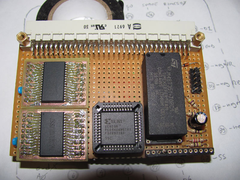

At the present it has a 256K memory 'expansion' ( in pages of 64 Kbytes of course ) and an SPI port with the intent ( still to be done ) to attach an ENC28J60 to it and try to experiment with some eth.

What makes this system a bit 'unusual' is that it can flip into a 'system address space' where I have a "BIOS rom" and a "BIOS ram" containing various code ( specifically routines to access the IDE disk, the bootloader and other things ).
The 256K expansion idea came cause at some point I was trying to implement that Z80 OS called "UZI" ( a kind of Unix like thing ) on it but for the moment I am still not really working that much on it.

The Ram expansion is here : http://www.gilesgoat.com/YakLog/RamExp1.jpg
it also has an RTC clock ( intended to be used for that UZI ).

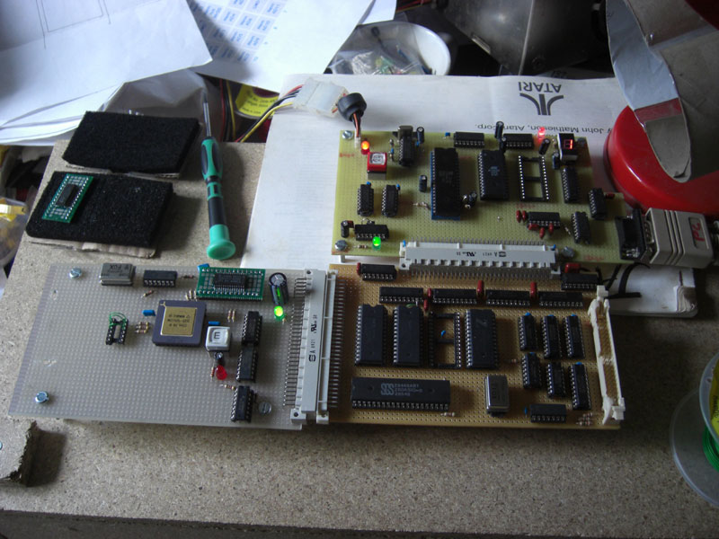

At some point I was experimenting with those chips as well ( INMOS T-425 ) but that's another story : http://www.gilesgoat.com/Yak/TrTest2_1.jpg

My system at boot has "the bootstrap rom" which contains a "console" with a number of things ( memory dump, peek, poke, stuff ) but most important the XMODEM loader and the 'disk loader'.
The xmodem loader allows to load up to 28K of something into ram, once is there it can be executed directly or saved to disk.
The disk in that stage as "a superminimal filesystem" or better to say is "a big file that is an array of 16x64K blocks" where you can save/load from, save means you copy from memory to disk, load the reverse.
The blocks can have a name assigned ( so can 'list the directory' and know what is in ).
The "BIOS rom" can ( as it is now ) be replaced with a 6264 RAM which allows me to load ( via XMODEM ) a new BIOS in ( while testing ) .. this saves me much burning of EEPROM, because RESET does not spoil the memory a few tricks are possible.
There are 2 bits used into an I2C port that drives a small display I ripped from an old TV box, just 4 digits but useful to spit out some debug info, the I2C protocol is all done in SW.

The ram expansion is basically "nothing much to say", except that it has the particularity to leave always the last 8K of ram address 'unswapped', this is where the "OS" ( or at least the non-remappable part ) should lie.
It adds 4 more 64 pages of ram plus the RTC, the idea was to use it for that "UZI" so instead of copying in/out from disk it should just "flip a page" when swapping processes.
