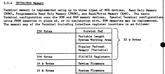

I was mistaken about how much memory the terminal has.
The memory map is here. It is also obvious why the roms are grouped in
two blocks.
The TD83x series was available in many different configurations with additional
peripherals as options.
