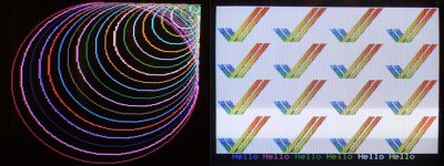

Hi, I just released my C64-V9958-Cartridge!
It adds the Yamaha V9958 MSX2+ Videochip with 128kB RAM to a C64: Up to 512x212 (424i) pixels, 256 or 19000 colors, 32 sprites. I also wrote a complete BASIC extension to use mode 6 and 7 incl. sprites. Everything is on git: https://github.com/vossi1/c64-v9958-card
