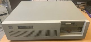

Yes, I have pictures of the machine that I bought as shown in pictures below. Yes, I knew that the 5170 was a 80286 machine. I bought a 286 for the purpose to conform to the principle of the 286 platform on this machine. Of course, getting an original IBM 286 Motherboard was a bit too pricey. I had to settle for another unbranded 286 motherboard. The 386 is okay as far as I can tell, except for one of those Dallas RT clock blocks that is soldered to the motherboard. There doesn't appear to be any leakage of the internal battery as far as I can tell. I didn't take any chances that the Dallas would fail by acquiring the NTX287 RT clock exposed battery assembly and socket to replace the Dallas; but it will take time as my Parkinson's will play a role in handling a soldering iron.
The attached file, Case front.jpg, shows the front of the 5170 case received. If you notice the hard drive was sitting in the floppy bay. I have moved the drive to the center bay. and placed a 1.44-MB floppy into the floppy bay. The next picture shows the case back.jpg. In this picture, a MDA card is shown. I removed the MDA for a VGA card since I don't have IBM 5151 or 5153 monitors. The last picture is the internal part of the 5170 I acquired. Like I mentioned in my initial post, the acquired 5170 is a hodgepodge of parts to with nothing original except for the case.

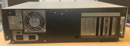

Okay, I went back and reread your second post where you did say it was a "hodgepodge". So, you don't really have an IBM 5170. You have a CASE iof a 5170 with a non-IBM clone DTK 386.
You can test the power supply by taking it out of the case and attaching a hard drive to one of the drive power connectors. If it powers on the hard drive will spin up and you will hear it. You should also hear and see the fan from the power supply. You can then use a multi-meter to test the power rails output.
Maybe the power switch itself got broken in which case you can wire on a new switch or bridge the wires. Careful, you can get shocked. If you are not knowledgeable with AC power you should probably take it to some one who is.
