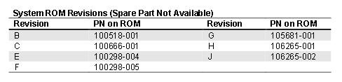

The best way is to look inside and see the part number of the ROM. Other ways might be to run MSD or something like that and check the date of the BIOS. Sometimes they will list a version there, but sometimes they lie to maintain compatibility with IBM or whatever.
attachment.php
Of course you might not actually NEED to upgrade past C, which is required for expansion BIOS, such as hard drive controllers. C also supports 640K of RAM insteadk of 544K or whatever it was previously.

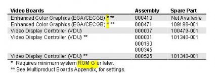

I'm interested in the later version because it says that the compaq EGA card requires G or higher:

In my Compaq Deskpro 286 model 2550, I have two ROM chips 105620-001 and 105622-001. I wonder what BIOS versions that is.
Yours is revision D.
It looks like Revision K marks the introduction of the 12MHz Deskpro 286 because that was the first available ROM available for it, and all ROMs after that were available for both the 8MHz and 12MHz models (same part numbers): K, M, N.3, P.1, R.2, and S.1. The 8MHz lists all those, plus these earlier revisions: A B C D E F G J.

Yes, just like with the original (8086) Deskpro and the Portable, the list of ROMs is the same for the Deskpro 286 8MHz and the Portable 286 (also commonly known as the Portable II). I have this information from the Compaq "Service Quick Reference Guide" which is a small spiral-bound book. I understand there was also a version of this available in PDF format at one time (several hundred small files, one file per chapter) but which I cannot now find online. Perhaps it was on a Compaq support CD.
