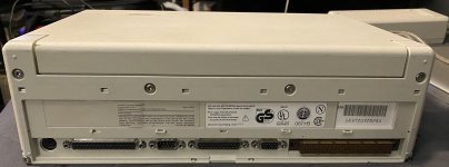

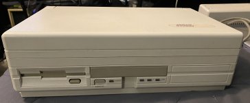

Here's some photos of the unit.
It is missing the rear port door unfortunately, but I'm not too worried about that.
One thing odd you may notice is that the label on the rear with the FCC ID and model number belongs to an SLT 386s/20! I was initially perplexed by this, but I noticed something under the sticker so I peeled it back and here's what I found.
I gasped when I saw that, because this 100% proves it is a prototype. That is leftovers from the old sticker that said something to the effect of "Property of Compaq Computer Corporation NOT FOR RESALE." I saw a pic of another prototype one that had sold on eBay many years ago with a label of that exact size in that exact location. I believe it also said something about the machine not having proper FCC approval yet from what I remember.
Really not sure why someone felt the need to peel that off and install a ID label for an SLT 386s/20, but oh well.
Another slightly unfortunate thing is that someone completely removed the original hard drive. They even took the entire drive enclosure and all of the screws! Thankfully, I had an extra drive enclosure and spare 20MB Conner drive, so I threw that in there. It's a Conner CP-3024, so it's not the exact drive it came with, but close. The original Conner CP-3021s are very hard to come by unfortunately, but I'll find one someday.
