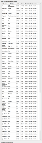

Looks like your HDD image is empty or broken. No files here.
Oops. *embarrassed* posted the wrong one. :)
Still no files. It is really weird that 10 MB image is compressed to 46 kb ZIP file. After unzipping and examine image with hex editor I see that whole hard disk contains UUU characters. Something wrong with ZIP? Can you try 7zip compression on image and or share/upload on external web page?
