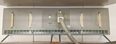

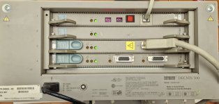

DECNIS 500 frame ( DNSXA-AD or DNSDA-BC ) with 4 installed modules:
DNSAN-AH B1000-AA CPU Module ( DECNIS Processor )
DNSAM-AH B1050-BA MEM Module ( 8MB Packet MEM )
W614/618 DNSAA-AA B1408 WAN Module ( Sync Card 8 Line DB50 )
L602 DNSAE-BA B1103-BA 2 Port AUI NIC Network Module
DNSXH-BX 4-Port Distribution Panel
BN23B-02 Cable to Distri Panel
Cable Guide and Rackmount Utils
BC190-02 X.21 Adapter Cable
H3199 Loopback Adapter
Up to now i did only a power on test - looking good.
The Unit wants to boot a MOP image, i have to figure out which and where this eventually is.
Who has worked with DECNIS and can share some experiences / Tips etc. :-) ?
And eventually did you notice that there is written DNSXA-AD on the frame itself, but there is also a sticker with DNSDA-BC written on it... --- So what is right / does that mean ?
