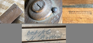

One other nit thing while I'm talking about these tape units.... I have 3x of these. On the first one that I got, I thought the black metal structure behind the tape unit was damaged (by having a small chunk missing from the top). I thought "that's weird, maybe it was damaged during shipping"
Then the 2nd unit had the same thing. That's weird.
And I notice yet again on this 3rd unit!! (see red arrow below in the image below)
This is looking down, but the black "bar" is actually a very thick and heavy metal plate.
So, now I'm thinking this nicked edge is just part of the process in how these plates were cut/prepared? Either intentional in how the pieces are cut (from a grid of plates or a larger plate?), or a post effect in how the pieces were tested??
Anyhow, if anyone comes across this in the future with their 5100/5110 or 5106, don't consider it damaged -- it's normal :D

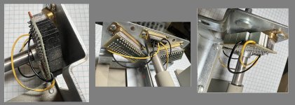

Here's the "glued in connectors" for the Slot A IO card. It has two "translucent" cables that wrap around to the external IO ports at the back of the system.
The little haze below the connectors on the PCB is glue, on both sides. I tried pulling them a bit, but didn't budge at all and I didn't want to risk damage. Probably a hair dryer and some time would soften them up, but I won't do that just yet. Want to try a few things with fresh new tapes first, probably be a week.
Ran out of time today to open up the terminator gizmo. I'm pretty sure it's just a couple patch wires across a few pins. Will get to it later this week.
Not sure why the bottom side of the terminator has a separate panel. I guess if you remove this panel (two bolts inside), the terminator can still be used, while also the internals can be probed and accessed - so maybe that's why it's there, expansion or some diagnostics?
And as suspected, just 4-wires of concern. But it's a tad bit more than just some patch wires -- the components on the backside of the little boards, unfortunately the label on those parts aren't exposed (on either side; the black stack side is 5-stack, while the other side is 3-stack deep).

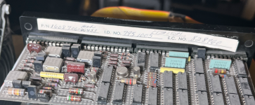

So I looked at the part numbers of tape-related devices across the 5100 and 5110, and there are a variety of Auxiliary Tape Adapter part numbers..
For 5100:
1606988
1607134
For 5110:
Tape Adapter 5106
1607134
1607144
1607146
There is one overlapping part number, but the presence of different numbers also makes me think it is possible that some early 5106's aren't compatible with the later 5110's..
I'm not sure which part number I have for the 5106. The 5106 (that I have) doesn't have a single obvious part number for the unit as a whole (e.g. on the outside of the case or bottom -- there is a part number on the black brace of the tape mechanism itself, but that number doesn't match any of the above -- and unclear if it refers to the 5106 as a whole, or just that internal tape mechanism). The cables inside the 5106 also have part numbers (and with dates from '75 to '77). On the inside of the 5106 enclosure itself, it has this date shown below: early 1977 (Valentine's Day in fact) -- which is a date before 5110's were even released -- which stands to reason that *this* 5106 didn't have the jumper pins installed (and associated tracing) to make it "future compatible" with the 5110's that came out in 1978.
(above: 5106 tape unit likely assembled in 1977, using some cable parts from 1975, and sold for use on an IBM 5100 that was built c. 1976 for use at a hospital)
Above: part number posted near the tape mechanism doesn't match the numbers listed in the MAP - interesting that these are handwritten and "TESTED"; just reminds me of the stamps and QC markings on an old 1886 piano. A much earlier manufactured product... Curious why the IBM label above isn't using stamps (like the ones you tap into an ink base).
So, nice lesson to know that don't for granted that just any ol'e 5106 tape unit will work with any IBM 5 1/2/3 00. Which also means figuring out any modern emulator replacement to the 5106 will work a little differently between the 5110 and 5100. Bummer.
