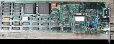

I do have a 286 with EGA on the motherboard and it has 256K video memory.
I also have a Paradise EGA card and it has 256K video memory, soldered, not socketed.
And I have a DataMedia EGA card with 256K on it (see pic).
There's three examples of 256K EGA video.
