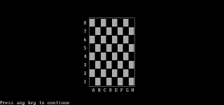

Added support for commands from the library, it was possible to draw a chessboard. However, for some reason, instead of arranging the figures, it hangs...
The program for QuickBasic 4.50 is in the attachment.

Please advise further. How can I use this library to print a string variable in graphics mode?
CALL SetCursor(x, y): Print fen$
Throws out of the program and displays a screen with such an error. At the same time, QuickBasic hangs.

PRINT won't work in Tandy graphics modes because QB isn't aware of those modes. You need to use PrintString or PrintStringX from the library.
String space corrupt is what usually happens when QB programs become sufficiently large. It's one of the many reasons we love and cherish QB. ;) Think of it as QB:s subtle way of letting you know it's time to optimize the code. :giggle:

Yes, already aware of this. The problem is that...
CALL SetCursor(2, 8): CALL PrintString(fen$)
and
CALL SetCursor(2, 8): CALL PrintStringX(fen$)
...do not work either.

PrintStringX is used in the city.bas demo. Does that work?
I guess I don't understand. You can pass whatever string you want.
fen$ = "blah blah"
Does it not output? Crash?

For some reason, it displays in the lower right corner, after which it hangs.
CLS
LET fen$ = "Chess-notation"
CALL MediumGraphics
CALL SetCursor(4, 4)
DOSBox 0.74, QuickBasic 4.50.

Sorry if it's a stupid question, just trying to find an explanation: according to GRAFIX documentation:
GRAFIX is a memory resident graphics and sound program for your Tandy 1000
series personal computer. It provides you with a complete set of graphics and
sound functions that can be executed from your favorite programming language
such as compiled BASIC and PASCAL. To use GRAFIX just install it when you start
up your computer by including the following lines in your AUTOEXEC.BAT file:
TANDY11
GRAFIX
Did you load those TSRs before running your BASIC application?
