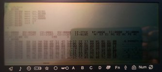

Hello, is there maybe a simple solution to discover the file system difference between the two cards using debug? For example to verify if it is FAT12 or FAT16 ?
That wouldn't help, because the format will be different for a 2 MB card. In any case, it's safe to assume both will use FAT12 (it's technically possible to have a FAT16 filesystem that small, but only if both the sector and cluster size were less than 512 bytes). And even if you had the correct parameters, you'd need to change more than just the boot sector to get a correct filesystem.
Looking again at the boot sector inside 2MFORMAT, the sector size is the standard 512 bytes, but the rest of the format definition makes no sense: the total number of sectors is something like 10 MB instead, with 8 sectors per cluster. I assume the code sets these fields to reasonable values, but I'd have to reverse engineer it to find out what these are. Also, the "hidden sectors" field - which is normally only used for hard disk partitions - is set to 1, which could hint at there being something on the card before the FAT boot sector (maybe the Card Information Structure defined in the PCMCIA standard?).

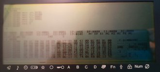

What you could try is the following in DEBUG, with the Poqet formatted card in B:
A 0100
MOV AX,0201
MOV BX,0200
MOV CX,0001
MOV DX,0001     ;change to 0000 for drive A:
INT 13
INT 3
<empty line>
G
D 0200
If there really is such a hidden sector, this might read it. But in any case, you'd need to get some kind of format program onto the Poqet, and writing one in DEBUG would probably be too much effort.
64 kB in A:
2 MB in B:
The interesting is that on the B: drive I can read POQET 2MB FAT12 in clear text, but the card has been formatted by the HP.
So there's no hidden sector, it's the same as the boot sector you'd get from the L command. "POQET 2 MB" is just the volume label. And the OEM name of the card in B: has been overwritten with garbage ending in "IHC", which is something that Windows 9x does, as explained in that page I linked earlier.
But I wonder why that's there, it means that you plugged the card into some Windows machine and it was recognized, at least enough for it to write this into the boot sector?
