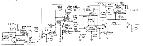

But the analogue board has a fault. I think its something in the Read/Write enable circuit. Getting nothing at the diff amp U2 during a read even though I know the heads on the drives are fine. As it happens with both drives, need to have a look at the common components.
Noticed that the output from the transistor array U5 is pulsing. Collector & base steady but the emitter is pulsing from 0 to ~7V and with the heads unplugged it just goes down to earth through a 12k resistor. So it looks as if its breaking down, odd. Its a quad pnp in a 14 DIL, Q2T2905 and there are not many about, same with the equivalent NTE2322, so I might have to take a risk with a China import :(
MPQ2907 looks like an equivalent on a brief check.
Dont quite know how I thought the base of the transistors were steady, but the digital board does indeed pulse them on standby. Odd.
So its not the transistor array.
Back to basics I think.
Format a disk with the good analogue board then try to read it with the bad and see if I can see any data at the test points after the diff amp.
New diff amp fitted. and signal now passing through both stages to the flipflop

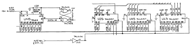

Investigation into the way the read circuit works
Data comes in to a flipflop which holds the data for reading into the shift register then in though some 74LS157 buffers
Then there is a strange circuit which appears to feedback to the clock input of the shift register and I surmise that it runs in sync with the data stream

Ah ha !
So I formatted a disk with the good board then attempted to read it back and got back on the last line
bdgccs instead of blocks
Reading out the binary for the ones that are wrong, in each case, bit 3 is 0 and should be 1 :)
ie, a 'd' is 01000100 in PETSCII and the correct 'l' is 01001100
So I need to trace bit 3 back through the shift register & buffers to the ROM at UK6.
Of course, the data from the disk clocked into the shift registers is not simple binary, but GCR encoded data and the single bit difference between 01000100 and 01001100 for the letter d rather than l is not a single bit in GCR, but two bits, ie 111001110 against 111001101 which seems less likely.
That suggests that the fault isn't in the bit that takes the serial data into a shift register then takes that parallel data into a ROM to decode the GCR, but afterwards.
The next piece in the chain is a 6522, but swapping that with a good unit doesn't fix it. I did check the leg to track continuity on the input ports but also need to do it on the data pins D0 to D7, then as the IEEE port is working, I think the next step is to test the RAM as I think I have a diagnostic program to do that.
