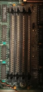

I inserted 4 of the sticks in the correct direction and tried booting, but the computer would not boot. I removed the sticks and it booted fine.
Is installing RAM in a 286 PC as simple as putting it in the slots and booting up, or am I missing something? Is it possible I was sent Mac SIMM RAM instead of PC RAM, or even some other thing, like Amiga SIMM? Is there any difference between PC SIMM RAM parts and Mac SIMM RAM and any other SIMM?
There's no difference between Mac and PC 30 pin SIMMs, they're the same. The only odd man out is IBM 30 pin SIMMs, which do have different pinouts on specific machines.
The only thing that could be causing issues is the fact it only has two memory chips (the 3rd smaller one is for parity) instead of eight or 9 chip modules (the 9th again being for parity.) Some machines don't play nice with high density memory modules that use four or two memory chips on them. Parity is another thing, some machines don't like parity memory.
Given that the memory stick diagram shows 9 chips, I will assume I need sticks of 256 kB. with 9 chips each. Now to search for them.

The chips I bought on eBay are 256K parity chips.

I can try 1 MB. chips if the 256K ones don't work, but according to the table above (not to mention the photograph of the manufacturer's sticker I showed) what makes you say it doesn't support 256K chips? It sure seems like it's explicitly stating that it does.
I believe the source in question is this th99 page:
https://th99.infania.net/m/C-D/30935.htm
However, the chart is nonsensical because it has the slots on the motherboard labeled "bank" 0-3. It looks like it might mistakenly think it uses 72-pin parity (x36) simms.
According to this:
https://books.google.com/books?id=Ob...200%22&f=false
The System 200 should have 640k built on to the board, supports 4mb of additional ram on the motherboard, and then up to 16mb ram if a ram expansion card is installed.
So the 4 slots on the motherboard might be be "bank 0", and then 12 slots on an expansion card, as banks "1-3". But that still does not make perfect sense, as that is a 286, and it should be possible to add just two SIMMs, making the 4 motherboard slots "banks" 0 and 1.
At any rate, if you don't have the expansion card, then logically it sound like 256 or 1mb parity SIMMS aught to work, for up to 4mb of RAM plus the built in 640k.
