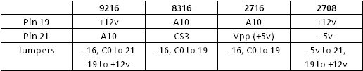

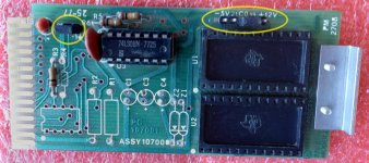

While working on restoration of my Sol-20, I've run across this thread a few times while doing searches about the personality module. For the sake of those who find this thread in the future, I'm adding additional information about the PM-2708 Personality Module and using it with 2716 EPROMs.
The PM-2708 module can be configured to work with a 9216 ROM (2K), an 8316 ROM (2K), a 2716 EPROM (2K) (and therefore 1/2 of a 2372 can be used as well), or two 2708 EPROMs (1K each). The most common configuration, and the default jumper settings on the board (PCB traces present), is for the 9216 ROM.
These ROMs and EPROMs are not directly interchangeable on the board without changing jumpers to accommodate the differences in pin assignments and power supply requirements as shown in the table below:
To make the board easy to use for any of the above combinations, I cut the default jumper traces on the PCB (-16, C0 to 21, 19 to +12v) and installed header pins in each jumper position. This allows use of standard push-on jumpers to select different options. Note that using 2708’s requires installation of the parts missing on the PCB shown below in order to generate –5v for the the 2708’s.
