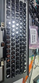

The keyboard was totally dead, but thankfully since it's a foam/foil capacitive variety similar to the Franklin 1000, it's relatively easy to refurbish. Other than the keyboard being DOA, both drives work great and actually pass through the fast disk verify of Locksmith 6.0 with my reference disks of all my other Apple IIs.

I just installed the foam/foil replacement pads successfully. You can find the set here:

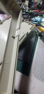

I've attached a picture of how the keyboard case opens. Someone before me kinda murdered mine getting it open, but if you see how the keyboard latches and the shape of the latches (there are 4 of them) then this will help you unhook the keyboard covers with less damage.
You will most likely need to replace yours since mine were nearly turned to dust after all these years.
Good info, thanks. Maybe the foam being compressed / turned to dust is why 3-4 of my keys are depressed. I haven’t rehabbed a foam/foil keyboard before so thanks for that link to the repair kit.
Another thing to check with your keys is if the spring is missing. There's kinda 2 parts to their function. The first is the foam/foil on the bottom of the key. The second is each key has a spring right under the keycap. So if you carefully pull the key from the top of the keyboard, there should be a spring in each one - yours might be missing a few of these springs. They are totally easy to misplace especially when you are pulling your keycaps to clean them and one accidentally "leaps" away to an unseen 3rd dimension.
There's a couple good tutorials on how to change the foam/foil pads on Youtube including one from the Texelec site that makes the pads. It's a bit of a fiddly process and takes some time, but you get into the groove of it and can knock all them out rather quickly. I cannot stress how helpful having a stainless-steel dental cleaning hook is for the job. They recommend it and I totally understand why now that I've done a few.

I finally got this Franklin CX all sorted out. Foam/foil keyboard works. Both drives are fully aligned. Power supply and analog board have been fully recapped. A whole bunch of little fixes (broken external composite video, missing Z80 card, rerouting video cables for better video quality, etc) This thing really is a brilliant little luggable - it's very sad that it never made it out to the market. I know back in the day I would have done extra lawn mowing jobs to summon the necessary money to buy one.
